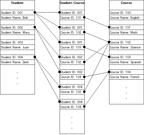

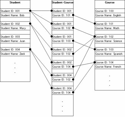

You use a join table when youi have a many to many relationship. A student can take many course and a course has many students a many to many relationship. The join file is use to reduce this to a one to many student to join and a one to many course to join. Think of the join table as a line items table. It can hold additional data.
Maybe a picture will help.
Without the join table, it is not possible for a Student to have multiple Courses (ignoring multikeys). With the join table, we can use a Student-Course portal in Student to see all the courses each student is assigned. We can also use a Student-Course portal in Course to see all students assigned to that course.

Think of the join table as a line item table for students using student id as the key and as a line item table for courses using course id as the key. Each record in the join file has both of these key fields filled in. These are called foreign keys. The primary key is a concatenation of the 2 foreign keys. This is standard relational database design. See any text on the subject.
The "conventional line item database" you must be thinking of is a Student table with line items of courses. This line item table of courses is essentially the Student-Course table. What it is missing however, is the Course table, where each record is a unique course. If your current system involves enter existing line items by typing in a description along with other line item details (with nothing automatically being entered,) then you probably have a one-to-many relationship.
When you connect another table (Course) to line items as a many-to-one, the line items becomes a join table (Student-Course). There are a couple advantages to doing this:
1. Automate data entry. Users no longer have to enter all the details for every line item, they just have to enter the ID for the related record, and the other line item fields can automatically populate or show through the relationship. Enter the Course ID, and see the Instructor, Start Time, End Time, and Days all populate.
2. Show join table records from the other side of the relationship too. Go to a Course and see a portal showing all Students assigned to that Course.
3. Normalized data; there is only one originating place for each unique piece of data. By having the Course table be the source for course data, you can change the Course data in the Course file and all Student-Course assignments can automatically get the update because they refer directly to the Course table. Want to change the Instructor? No problem, change it in Course and all Student schedules automatically reflect the change.
