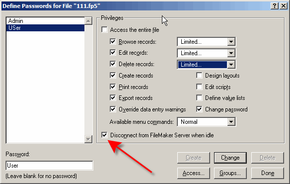

On the server, are you using passwords have you set up the passwords to the database so that they will not disconnect from the server on idle?

I don't recall seeing a dialog box similar to your screen shot in the Server configuration stuff but I do believe that there is a Disconnect when Idle setting and I think it's NOT checked. But I will verify to make sure.
