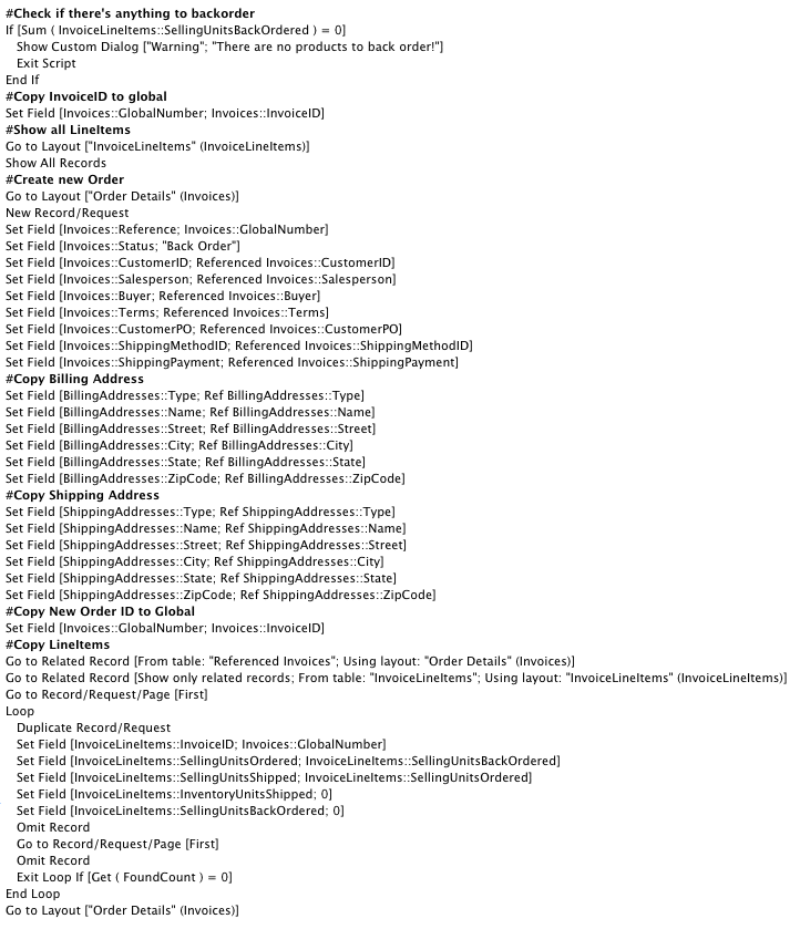

I have a script that's giving me some trouble. The last step is a Goto Layout, but it doesn't work.
Actually, the script step executes, but then for some reason the layout switches. I added custom dialog steps before and after the Goto Layout. When the second dialog come up you can see the window switch to the correct layout, but when you dismiss the dialog (which is the very last step) the window switches again.
Very annoying. Is this a bug? I can't find anything in the techinfo at filemaker.com.

What layout is specified in the Go to Layout [] step -- it's the bit in the brackets.

Vaughan has probably nail the problem in suggesting that you check which layout is there (ScriptMaker will have it defaults to (original) unless you name one).

The part in the brackets is "Order Details" (Invoices)
This is actually the original layout I'm starting from. I've tried setting it to be original layout, but that doesn't work either.
I've determined (with the dialogs) that this script step is working as it should, but the layout is being switched after the script ends.

Ok, here's a cap of my script
Is it perhaps called by another script?
Nope, it's called from a button on the "Order Details" layout.

So I tried calling my CreateBackOrder script from another script that has a Goto Layout ["Order Details" (Invoices)] after the Perform Script, and I still get the same behavior.
I can't tell what's causing this. I'm pretty sure it's a bug, but I don't know why it's not cropping up in my other scripts that do similar things.
