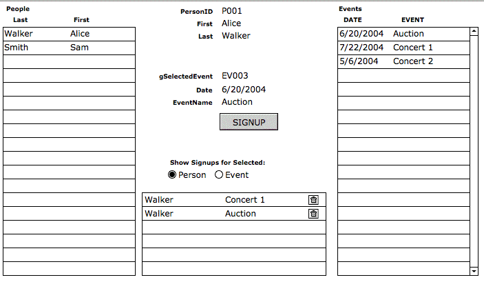

Yes, you need a signups table. See attached.
It will probably be better to use different layouts. But you don't have to. You could put portals to the people file, signup file, and event file on one layout.
A list (portal) of all people on the left. A list of all events on the right. Click a person, his detail shows top/center. Click event, the event detail shows up in the middle center. Bottom center is a portal of people assigned to the event. With a little trickery you could even get the bottom portal to show all people for selected event or all events for selected person.
Events.zip
Like this...
