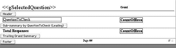

If the survey is all in one table, then using richMac's method you would need five calc fields for each question, or 110 calculations. If this doesn't appeal to you, you can try using a GetField() calc with sub-summary parts instead:
gSelectedQuestion (global, text) //this is for the name of the field that is to be summarized
QuestionToCheck (calc, text result) = GetField(gSelectedQuestion) //This will show the Answer for whichever question was entered in the gSelectedQuestion field.
CountOfRecords (summary) = Count of RecordID
On a list layout, use a Sub-Summary by QuestionToCheck part instead of a Body part, and insert fields QuestionToCheck, and CountOfRecords. On the Header, insert gSelectedQuestion.
Now when a question's field name is inserted into the gSelectedQuestion field, the records are sorted by QuestionToCheck, and the layout is viewed in Preview Mode, you will see the results for that question summarized.
(If you were looking for a way to view the summary results of ALL questions on one layout, the algorithm is more complex, but it can be done without adding 110 fields.)
