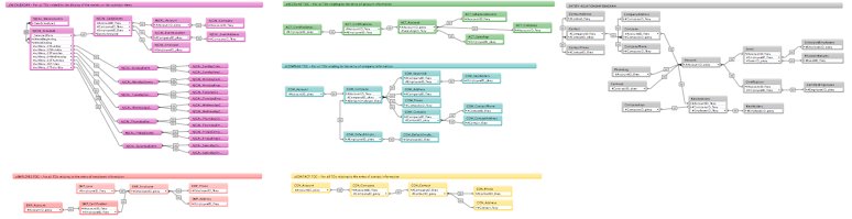

I am not sure why you are using the Task table as both a main table and a join table. That is bad design and may end up confusing you...add an actual join table.
Remeber that in Filemaker you are NOT designing an ERD (although you can) you are also defining business logic.
Your ERD may say that POs have one or Jobs which have one or more Tasks, so you setup the relationship that way, which is very similiar to what you have now..
Then define all your relations that are part of the business logic, remeber that you can have multiple unrelated Table Occurance Graphs (ToG):
POs have Tasks with no Jobs.
Jobs have Tasks with no POs.
So setup new TOGs with those two business logics.
Look at the attached example...all the colored groups are business logic groups...only that grey grouping is the ERD and I do not actually use the ERD group in any of my development...it was just there for referece. I just use the colored groupings.

Basically the Filemaker relationship graph show both ERD and Business Logic. The ERD may say that POs have JOBs which have TASKs. But business logic says that sometimes a PO has TASKS but not a JOB, or that sometimes a JOB has TASKs but not a PO. You would then design the solution with at least 4 different graphs of table occurances and thier relationships.
One graph would show the ERD (not a necessity), another graph would show the normal PO->JOB->TASK relationships, another the PO->TASKS relationships and another the JOB->TASK relationships. This is like the Pink vs Blue vs Yellow vs Red vs Green graphs of Table occurances in the above example. Those are all variations on the same sets of tables, with differing relationships to each other.
