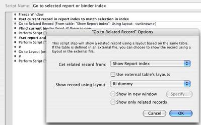

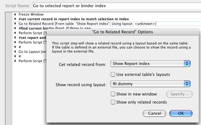

One weird thing: after I changed the Show record using layout: to the newly-created dummy layout, it still shows up as <unknown> in ScriptMaker... guess there are still a few bugs in 7...
I've attached a screenshot.
Yes, I believe this is a bug that has been discussed before. It still works though, and that's what matters.
