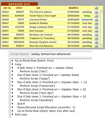

I've put a script together, but it has one small bug which I can't figure out. I've attached a screenshot here of the portal and the script itself, so you can see how it's working.
All the fields you can see in the portal are from the table 'jobsheet 3', except for the unlabelled field on the right. The field under the label 'deadline' is the field named 'finished art' in the script. The field 'update::date' in the script is a field in the current layout which always contains today's date (currently 29/09/2004 - european date format dd mm yyyy)

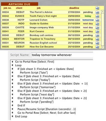

The sub-scripts in my main script insert the appropriate coloured text in the unlabelled field on the right. The problem I'm having is that the script returns an incorrect result ('pending' - should be 'late') in the first line of the portal. All the other results are correct. Also, if I remove the 'Pause/resume' step after 'end if', the script returns 'pending' in all the portal rows.
Any ideas?
I think it would be cleaner and more accurate to Go to Related Records [show; relationship] and loop on the found set instead of looping through the portal. Also, use Get(CurrentDate) instead of Update::Date and see if your results are correct.
Alternatively, don't use a script at all. Make your Pending/Today/Tomorrow/etc. field an unstored text calculation in the related table that uses the tests in a Case statement and returns the appropriate TextColor result.
