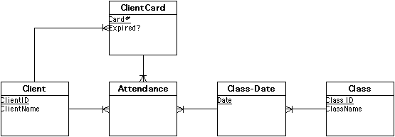

I think a better database architecture would be to have these tables: 1) student, 2) class, 3) class date, 4) join (student-class-date). Each student would have a unique ID; each class would have a unique ID; each class date would be unique.

I would recommend not splitting your past and current membership cards. It's easier to keep them together in one table. Just change a Status flag when a card is used up or expired. Then use a filtered relationship to the ClientCard table, to show only those that are not expired.
I think what transpower was driving at is creating a table for the Class (Course) info, that doesn't change for each date. This is helpful if you want to pull up the "Basketball" class, and see in a portal, all the Class-Dates (Sections) for that class. You may not need to track this information for your membership cards, but I have attached an ER diagram that may help.
"I'm not sure I follow you. I don't understand why you suggest separate tables for class and class date..."
My assumption is that you have an ongoing class, say for a semester. Is that not correct? If so, then my understanding was that you wanted to track student attendance; you would then have one record per student-class-date in the join file.
Regardless, I agree with Ender that it would be a mistake to split up your past and current membership cards; I take this to be your student ID's and these should be permanent.

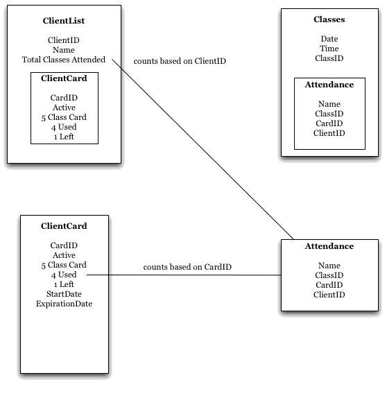

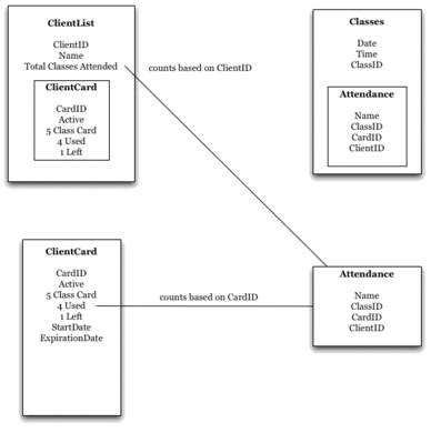

Here are the tables:
ClientList
ClientCards
Classes
Attendance
(I've attached a diagram to illustrate the relationships.)
The problem occurs when a client attends a class. The Name field in the Attendance portal is a Value List based on the Name field in ClientList. When I enter a name here, Attendance looks up ClientID from ClientList and CardID from ClientCards. I am then able to count how many times a particular Card has been used (from Attendance) so that when the 5 Class Card has been used 5 times the card status changes to "expired." All well and good. I can also count how many times a Client's Name appears in Attendance, allowing me to track the total number of times they have attended a class. When a Card is expired, it needs to be replaced with a new Card. Now the challenge is how to have the Attendance portal in Classes pull up the new CardID instead of the expired one? I hope the attached diagram makes this clear.
This is why I was originally thinking I might need to create a script to export expired cards to another table, reset the fields to allow me to then modify the existing record with new values. As long as each Client only has one class card with a unique ID, the counting works. If I keep the current and expired cards (records) in ClientCards, how does the Attendance portal lookup the correct card ID?

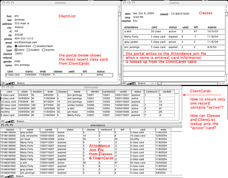

I'm still stuck... I've done what you suggested but I still have a problem. I think this would work if I was using the ClientCard ID to add names to Classes. Unfortunately, the "cards" are virtual - there is no physical card and I don't want to have to pay attention to the CardID. I want to use the Name field as my primary key. Each client (Name) will have multiple records in ClientCards. Ideally, only one of them would be allowed to contain the status, "active" and the other records would all be "expired." I want to be able to enter names into Classes and have only the most recent card information looked up - whether it is active or expired.
I've attached another diagram to illustrate - this one is of the actual tables in FMPro.
Thanks again.
The status field for ClientCard should be calculated, so that when the number of classes is up, the status field changes to "Expired." Another field, also calculated, stores a concatenation of the status field and the CardID; this is the field which would be related to the similar field in Attendance or Classes--so when you do a lookup only records which have active status would match.
I don't think this will work. If the Status field is a calculation based on a relationship, it cannot be stored, and therefore cannot be used in the match side of a relationship
The status field *is* a calculated field. I've also already got a concatenated field combining CardID and status. The problem is that I want to do a lookup using Name as the key. As long as I have multiple records containing the same name I don't see how it's possible to link to only one of them. I think this is possible because I use a proprietary windows program that does exactly this. Unfortunately, it's a discontinued program that is no longer supported and I don't have access to the source code to see how it was done. I'm trying to create my own version of this software using FMPro. I actually spent a few weeks trying to solve this last year -- even paid someone a hefty consultant fee to help me figure it out -- but ended up giving up in frustration. It seems like it ought to be possible but the solution escapes me.
Given the difficulties, does my idea about splitting up the class cards into two tables sound more feasible? If I have a table that only contains one Card record per name then looking up the current data is simple. The problem then becomes one of how to keep data from and maintain access to past cards once they are no longer current. Hence my question about whether or not it's possible to create a script that...

I've attached an archive of the files (stripped down) in case anyone wants to take a look and see what I'm trying to do. The question still to be answered is simple - alas, a solution may not be.
You will see that mister jones has three class cards, two of them expired and one active. When entering mister jones into the Classes database, how would it be possible to have the CardID of the "active" record looked up and not any of the others?
