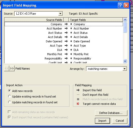

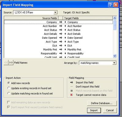

Hey Fenton,
Thanks for your help. I've been getting a lot more done as I see the things you're talking about. I've attached an image of the box I'm talking about. Based on the way you're talking, I'm wondering if you haven't seen what I'm talking about on the import dialog. It only has the drop down for me on the import script step. I have solved my issue with the Layout Setup options.
Seems strange that it wouldn't allow me to select the relationship to import to on the File/Import/File option.

It can choose which table to import FROM in another file, because it is only reading data. But it can only import INTO the current table; because it's writing data (I don't know the technical details, but that's my understanding of it). Think of Go To Layout as "choose the table."
