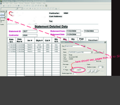

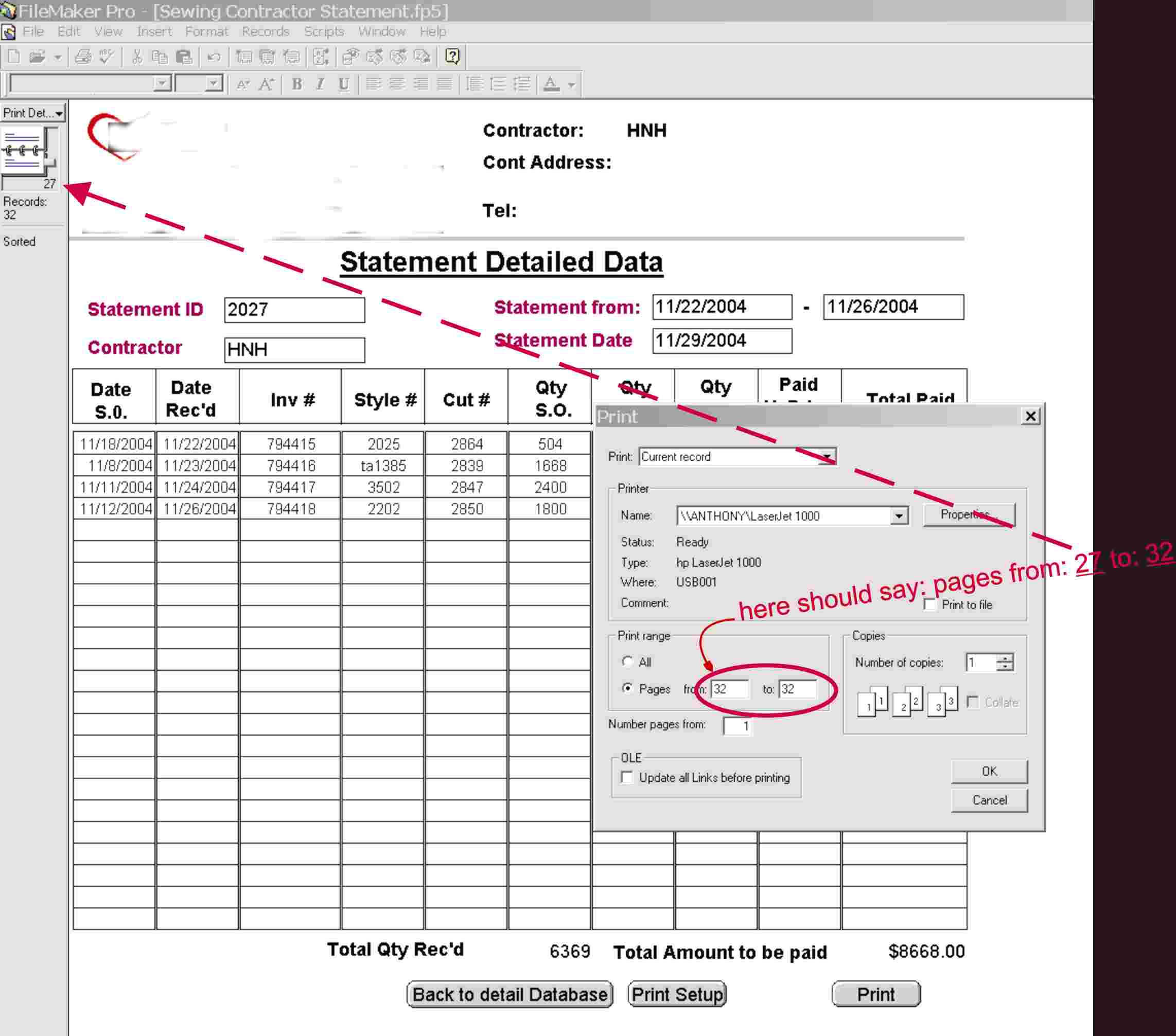

I created the setup, but i still have to input the page I want instead of just clicking ok on the print window... see the attatched jpg image... hope this is a better explanation smile.gif
Well, if you have it set to print Current Record, then the Print Range will be ignored anyway. If you want to print more than one record, you will have to use Records Being Browsed and then enter the Print Range. And if the range changes each time, then you will have to manually enter it each time. And just in case you weren't aware, the Current Record is the record selected in Browse Mode, not the page that you might be on in Preview Mode. If you are on the fifth record, and you enter Preview Mode, it will show the first record as the first page, but the fifth record is the one that will actually be printed.
