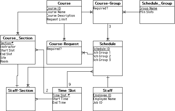

To give you an idea of what's involved in a relational system, you can take a look at the ER Diagram of the first version of my Scheduling module (see attachment.)

The Day_Time_Student table is close to what my Staff_Section is. But since some classes could be longer than one time slot (at least in my case,) it makes more sense to relate to a multi-key of time slots that the class uses, rather than having a join record for time slot for the same section.
So yes, you should break it down into the smallest parts (for the join table,) but that's only a small piece of the solution. How you frame the data entry, reports, and individual student schedules is the hard part. In my solution, I have our staff choose courses they would like to take (that's what the Course-Choice table is,) then a script will go through and slot everyone into sections based on their choices. The end result is class lists (a report in the Staff-Section table,) a master schedule (a report based on the Course-Section table,) and individual staff schedules (a form printed from the Schedule table, showing one day's schedule of related Staff-Section records.) There are of course, other ways to view and manipulate the data, but that the basic functionality.
