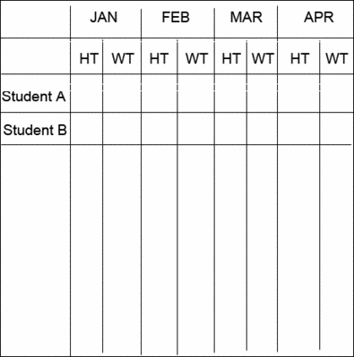

I've been asked to create a report that will track students' height and weight over time. I have a 'students' database that holds the height and weight information. I could easily create a list report that just lists the students' names plus their height and weight, but I've been asked to have the report display historical data on this. Specifically month by month. Attached is a quick sketch of an idea of the layout of the report.
At first I thought I'd need a wt/ht db where one month was one record, but that seems wrong. Any ideas? Thanks in advance.

Using regular fields (or repeating fields) in Student to hold each month's height and weight may be the easiest to get the output in the format you showed.
If, however, you also need to do other things with this data (collect more than one year's data, graph it, or compare it to the average height/weight for a student of that age,) then I would recommend putting each month's height and weight data in individual records in a related file. It will be a little trickier to show 12 months of related records in the format you indicated, but it will be easier to do those other things with the data. Data entry can be done using portals to the related file.
Although FM7 has many great features, this project can certainly be accomplished with FM6. Converting to FM7 later will be no more difficult because of this additional module.

I don't believe a sub-summary report would work well for seeing the data in the format panache indicated, however it would be simpler to create and may suit panache's needs. The nice thing about a sub-summary report, is it would show if a student had more than one screening in a month. Unfortunately, it would NOT show data on a month if there was no screening that month, it would just skip to the next month with data. This may not matter. On the other hand it might be important to quickly see when a month has missing screenings.
By using explicit pidgeon holes (either with separate relationships or repeating fields,) you can get an overview that looks like panache's sample, showing when a month is missing data.
It just depends on what panache really needs.
