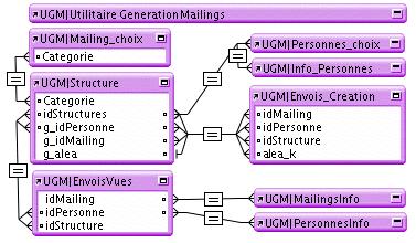

Without a view of the graph, it may be difficult to exactly understand what is going wrong.
As a rule, you need to make sure there's no valid relationship in order to create this new related record. I would think that an additional global key with a date and Hour field would make sure that the combo Person-Mail-Date-Hour will result unique.
Otherwise, the match will happen to the first related record.
Another technique would be to populate a random key in a global and add this key to the relationship with its twin key being random_k.
Then you'd absolutely make sure each combination is unique.
As a matter of fact, I came up with this construction some days ago for a fellow on a french list, that had some specific mailing needs.
The namings are french but it is a Mailing Generation Utility Module where the user, when in the current Company record (Structure), dynamically pick related persons from a Selection Portal on left (Personnes_choix), and then a Mailing Type in a portal on the right (Mailing_Choix).
Setting the aleak in Envois_Creation (translate Sendings) then creates the new record ready for the mail to be sent.
The g_alea, which is a random scripted key was necessary, as a person could receive the same mailing "type" twice, but as I explained it could have been easier with a gdate and ghour, but unfortunately, this wasn't possible there.
Obviously, this same construction in a loop would be possible.
HTH
Hi Ugo,
The attachment I included in my previous post has a screen shot of the relationships. Is that what you mean by the graph?
Thank you very much for the attachments and for your suggestions. I'm working with a non-profit for whom Filemaker was the best solution for a number of reasons. It's great in that with a combination of a template and scripting I've been able to get them a working application that they could pretty easily take over on their own (if I were to be hit by a bus or something :-) ). The way relations are handled though seems very quirky. I'm used to database building applications (such as Access and 4D) where relationships and the use of parent and foreign keys are much more straightforward. In a Many to One relationship, when a NEW Many record is created why does Filemaker even attempt to "match" it with an existing Many record?? I don't understand this logic at all. The only thing it should be attempting to match a new Many record with is its One record and that is very straightforward; you just grab the key of the One record. I don't understand why Filemaker makes this so complicated. But thank you very much for your help.
rlbryant

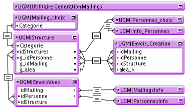

HTH

Hi Ugo,
I'm sorry. I took a screen shot of the relationship graph; I'm not sure why it doesn't appear in the Word document. At any rate, I've been informed that the script is not working because I am not properly using the "dual" (I'm not sure of the proper term) relationship that I've set up using the global ID field in my Contacts table so I will redo the script with my new understanding of the instructions. (I have the relations set up correctly but am not always referencing the right tables in the script.)
