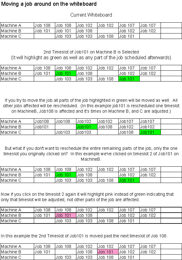

I made a picture to better describe what I'm trying to accomplish. Basically I work for an industrial shop that has about 30 machines that jobs are running or reserved on. I'm trying to make a scheduling program where someone can insert, delete, and move around jobs on a whiteboard. Since the people who'll be using the program are not usually around computers I'm trying to make it as simple as possible. I thought about having drag and drop blocks (sometimes a group of blocks if a job is spanned across several machines at different times) but to be honest I'm not sure if it's even possible (although I think almost everything is possible in FM7 if you're creative enough).
The added benefit of this scheduling program is that people will be able to see the affect new jobs have on older ones or what happens to all the rest of the jobs if a particular job is moved. And they'll be able to see which machines are being under utilized and which ones are swamped with work.

In your example you first moved 101 to the place that 108 was on. Then 108 had to move up one. What if there wasn't room there? An error would have to stop them. It seems to me that it would be easier to have them move 108 first, then move 101. Also, I don't see why they had to move on Machine C; they weren't overlapping. But what do I know :-?
