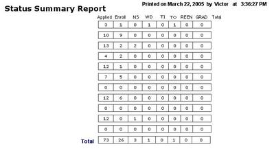

i was wondering if someone can help me out with this. Basically i have a summary report base on the field call status. The status field is drown down menu.
I have one calc that is not working me. This how i have it,
i have the fields:
c_Withdrawn Calculation = Status="Withdrawn"
c_cnt_Withdrawn Summary = Total of c_Withdrawn
c_c_cnt_Withdrawn Calculation Unstored, = Sum(c_cnt_Withdrawn)
The calculation works as long I change the Status name to Something else.
any help would be appreciate it.

Brian,
I try it the way you say and it doesnt work. The crazy part is that i i used a different status and it work fine.
is Withdrawn a FM Reserve word?. i am using FM 6.0 by the way.
thanks for you help. i thnking of rename the status to WD-Withdrawn since that work for me.
thanks
victor

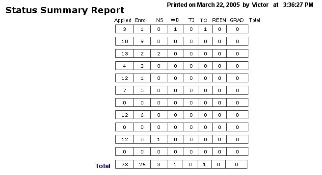

Comment,
I used that field to the sum of all withdrawns and display it in sub-summary report i create. I include screen shot of my report.
I just end up rename the status field and it is work fine now.
Thanks all for the help. i really appreciate it.
