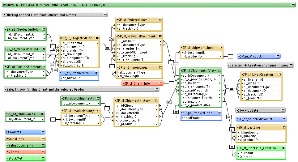

When working with businesses involving partial shipments of orders, or partial orders of quotes, or on the contrary fusions of more than one order into a shipment or/and multiple shipments into an invoice, the solution should begin within a specific construction of the Line Items.
Basically, having a Line Items where one same record would hold either the orderID and the shimentID (even with different quantities) is troublesome. Splitting the Lines into 2 separate Tables also prevents for any real comparisons from one "document" to the "other", as requested here.
Having faced these situations, I would actually highly recomand to integrate these scenarios even when they shouldn't happenr, as noone knows how business would evolve. When this wasn't taken into account from the start, it becomes a real nightmare to rethink the database diagram, or to adapt the solution for some oddities.
I was going with a 4 files (Quotes.fp5, CustomerOrder.fp5, Shipments.fp5, Invoices.fp5) and a Line Items file stucture in FM5, but I recently migrated to a 2 Tables solution with a SalesDocument Table and a SalesLineItems with FM7.
With such solutions, you need to "track" each line individually, from the very start of the Sales decision to its ending point, and this, IMO, is done by introducing a TrackingId and referencing it as the main key of each transaction and document.
Here's attached, in case you can dissect it, an extraction from my own graph.
I adopted a Shopping Cart technique where once selected a Customer, you may pick an item ???
- from his opened lines, including those partially shipped
- from the Catalog, with a way to match either old purchases made by this customer for this product or eventually again all possible opened lines for this product and customer.
I sligtly changed it to match the Shipments only, but the process is always the same, whatever the document we are building (Quotes, Orders, Shipments and Invoices).
Hope this isn't too confusing.

LineItem Structure
_____________________________________________________________________________________________________
lineItemID - unique random ID
customerID - text
documentType - text - 1 for quote, 2 for order, 3 for shipment, 4 for invoice
documentID
quantity
price
lineTotal
c_quoteFilterKey - equal to "1" (referencing documentType-could be auto-entered text)
c_orderFilterKey - equal to "2"
c_shipmentFilterKey - equal to "3"
c_invoiceFilterKey - equal to "4"
trackingID - text indexed - unique Random set by script once and propagated later on -
Then 3 indexed textFields that get scripted along each transaction, which are the result of calculations within 'selfjoins' in the Line Items, and that are used to filter down the lines to the tragetted ones...
notAllOrdered
notAllShipped
notAllInvoiced
For example, notAllShipped is the result of a SetField[ ] using the context of the PreviousDocuments in the Graph, and converting the result of this calc.
Case(
//This is an order//
documentType=2;
//no line with this trackingID and a documentType = 3 (shipment)//
Case(IsEmpty(ShippedLines::lineItemId)
//OR//
or
//There is at least one line with this TrackingID and a documentType = 3 (shipment), but the quantity shipped is inferior to the quantity ordered//
not (Sum(ShippedLines::quantity) >= quantity);
//Returns Line ItemID so we can dig farther into the relation by referencing it//
lineItemId;"");
//The Document is a quote//
Case(documentType=1;
//There is no line with this tracking ID and a documentType =2 (order)//
Case(IsEmpty(OrderedLines::lineItemId)
AND//
and
//This quote wasn't directly shipped either - because it can happen that the customer is delivered from stock without any order//
IsEmpty(ShippedLines::sl_lineItemId);
//Return the LineItemID or nothing for further investigation in the relationship//
lineItemId;"")))
As you may see for this "calc" structure, the process being the same whatever the documents, you'd be increasing the documentType to filter either the lines to be ordered from the Quotes *point of view* or the lines to be invoiced from the Shipments *point of view*.
Documents Table structure ???
documentID - unique Random autoentered
documentDate
documentNumber - the classic Quote#, Order#, etc.
documentType (1 for quote, 2 for order, 3 for shipment, 4 for invoice)
c_PreviousDocument =
Case(//The document is an order//documentType="2";"1"//previous document is a quote//;
//The document is a shipment//
sd_documentType="3";
//result can be either a quote or an order//
"1
Wow. Thanks Ugo. It's seems pretty clear. The basic idea being that you can handle the progression of an item through the process by using a document type for the overall transaction, and tracking# for the indvidual line item (which may have more than record as it moves through the process).
I'm intrigued by the "g_magicKey," which I can't recall. If it's not too much writing, do you have any documentation or link to that?
The magicKey is something I first referred as an oddity, and then decided to use as a feature for creating related records on a multipredicate join without even moving to a specific layout nor specify globals to be passed through as with FM6.
Bruce was one of the few to read my long post here and on Experts a while back, he has "officially" nothing to do with this "magic" word, but he sure helped me a lot to re-interpret this oddity.
Sorry I'm in a hurry but if you do a search for "magic", you should see a few posts.
