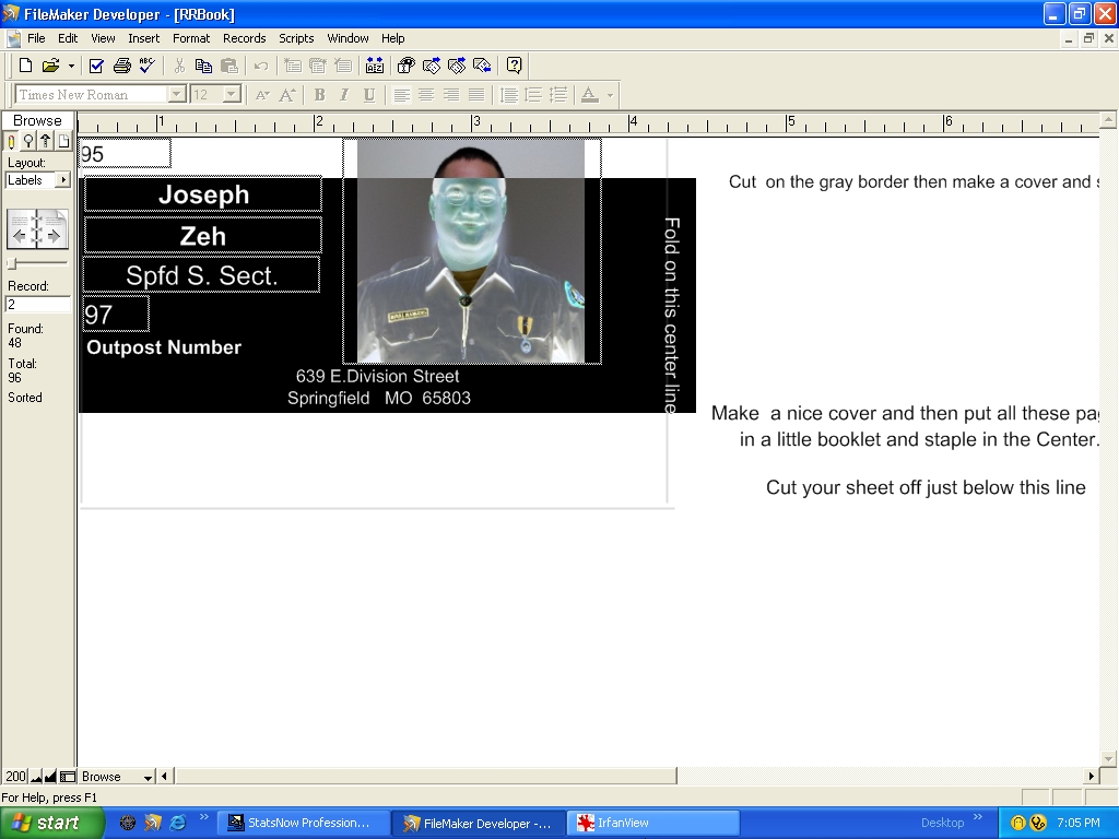

Hi guys. Well you did such a good job telling me how to sort and print the Top page of the booklet and I got to thinking
I wonder if you could figure out a sort for bothsides and a script to get it to pause between sorts.
This is way beyond my abilities. What do you think? Here is the layout specifics.
Booklet Printing. Front and Back Pages. Need a pause between Backside and Frontside to reposition the paper in the printer.

Darn, I was hoping that maybe your printer driver would solve the last problem. My brain it too fried to think about this tonight. Maybe I'll come up with something tomorrow.
I am not sure what you're after with the paper up/down thing. Here's the thing that does the split between passes. If the second pass needs to be printed in reverse order of pages, it is a simple matter of reversing the main sort order. One could even set up a global flag to handle various printers - but I am not getting into that, nor page numbering.
bookletPrinter.fp7.zip
I was probably just getting carried away. The reason for needing to know the paper position is so that you can take the printed pages out of the printer in a stack and reinsert them into the printer to print the second side without having to re-order the pages. Depending on the orientation of the paper, the output stack may be in reverse order. Running them through again to print the second side, will reverse them a second time, leaving the final order correct, but in that case, the printer must print the second side in reverse order. I wasn't sure if Mark was taking that into account.
As it turns out in this case, with two pages on each side of the sheet, the problem corrects itself. As you had mentioned earlier, its only necessary to print using the even page numbers as the print order (and by page number, I mean 4 per sheet, not 2) and pause after half are printed, then print the rest. Mark's last example is really 12 pages in the final bound booklet. So, the page order in printing would be:

I printed the booket from your solution and it did the trick and did it wonderfully. So I spent the evening getting ready for a Big Ranger Mobile Race Saturday and adapting your code to my solution. I had a few things I had to figure out with importing scripts. The * in the front and the end of a script was a new one for me. So it took me a while to figure out why those imported scripts didn't work. There are a lot of things to convert mainly table names and field names and I changed the show all records steps. Also the find script steps had to be adjusted.
I am tickled to just have this about wipped. All I need to do is get it to a printer and give it a test...
Your math skills are awesome and the way you do it by sending over a fm7 filen allows guys like me to beable to figure it out and learn a few things at the same time. Thanks for the Good Work.

See if the attached meets the specs. Note that label contents are placed in an invisible portal to source table.

I have been looking this over. You have done a nice job. I have a question what is in browse mode the black box that is in the middle of the label. I can't seem to edit it or change it. I think it is the invisible portal you referenced in the previous message. I am new to invisible portals...here we go a NEW FENCE POST!
What I have in mind is using the source layout to import data into and then use your cool, smart scripting and calculations to get the records sorted in the right booklet order and print. Then return back to my solution. I have most of this working and am triping over the invisibile portal.
Thanks for your lead here. I imported records into the source table file and added the 9 data and one container fields. This will fit the need nicely.
I enjoy the learning this stuff. Thanks.
Mark Jones
Yep, that's a portal all right. By "invisible" I meant it has no fill or border color. Judging from the pic you don't need it, so go to Layout mode, click on the portal creation tool and choose Select All from Edit menu. This will select the portal and allow you to delete it.
Thank You! I went to 400 scale and was able to finally get a handle to drag the portal bigger. I deleted the first file as I apparently messed the portal up and couldn't grab a handle..the second file had handles at least ones I could see. I have it working great. I spent most of the evening adapting it to my solution and printed off my second booklet. Your a DANDY! It works GREAT and does exactly what I wanted. I basicly am using it as a temporary import file. I export the data from my District Database pictures, text using a script then load the file you created and import my data into the additional fields. I changed the Label layout a bit and added some scripts to it. It works and looks good.
The original solution you made did exactly what I asked for but it didn't dawn on me a whole new math problem would come out of it. I will say I have spent more time on this little project and learned a bunch. I don't have the math ability that you obviously have but I sure wished I did. GRIN!
Thanks again Comment.
Mark Jones
