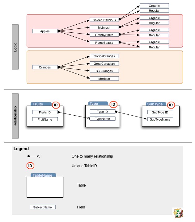

I have attached an illustration for a database I am making in Filemaker 7
I am relatively new to this program and understands the basics of FMPro ( I believe so ; )
In the attached illustration, I wanted to know which fields should I be linking in the relationships editor, whether my thought process as illustrated in the picture will work to implement the logic.

You need to add the corresponding foreign keys to the Type table and SubType table, and link each primary key from the parent table to the foreign key in the child table.
Type will have a FruitID field and SubType will have a TypeID field. The relationships will then be:
Fruit <=> Type
Fruit::FruitID = Type::FruitID
Type <=> SubType
Type::TypeID = SubType::TypeID
Thank you very much Ender
