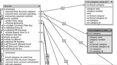

In a file called Journal, I have a 'Journal' table and data entry layout on which I have three text fields which I will call category, subcategory and subsubcategory. Using a file found here at fmforums entitled Conditional Value List_4, I constructed a three level conditional value list setup for these three text fields. The actual data referenced by the three value lists reside in another file, 'Setup'. 'Journal is related to 'Setup' by two table occurences, see attached picture.

To view other records from the same subsubcategory, define a self-join relationship:
yourtable::subsubcategory = yourtable 2::subsubcategory

Thanks for the help. Works of course. So apparent when considered, and more so on a new day with a clear mind.
