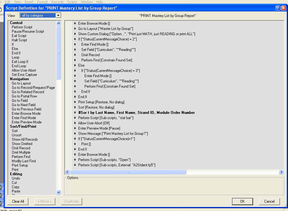

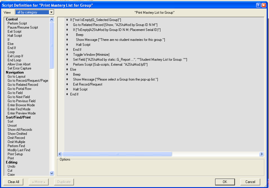

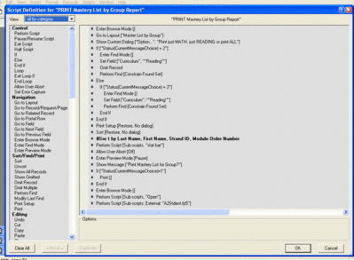

Attached are screen shots of the scripts, they are in the state i had to leave them with the code inline rather than modularized. the "Print Mastery List for Group" calls the "Print Mastery List by Group Report". These scripts are in seperate files.
I tried to modularize the 13 lines in "Print Mastery List by Group Report" that start with show custom dialog and stops at the second end if. That would make it a third level script.
This makes me wonder if there's a limit to how many scripts can be called or something since the my constraining find would work inline as it is in the screen shots but when I seperate it into it's only sub script that it doesn't.
Mostly I'd like to figure out why this didn't work for future referance as I just replicated the script steps I wanted to modularize into the 6 places I needed it to be and gave the application back to the client. I just can't see what would over-ride my constraining find if I break it into a module.
