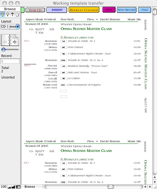

Okay - so now I have pictures to assist my explanation - I figure that's the easiest. My knowledge of the inner workings of FMP is minimal by the way. I know enough to have modified and reconstructed this template using calculations at the least, and I have put in about 6-7 hours of DVD tutorial, but that's it. I am on a summer project and need mostly fast results so I am utilizing this forum as a crutch and it has help *immensely* --
Anyway -

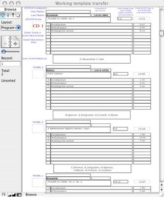

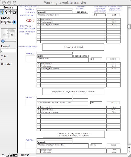

Picture 1: The program page, you will see where the composer's name is to be entered. You will see that the composer field for Work 3 is blank, this is because Work 2 AND Work 3's composer is "Britten." For database search purposes, we would like the composer to always be entered, even if it is repeated consecutively, however, we want it NOT to be repeated on...
Picture 2: The insert page, which is basically the back of the CD case.
The current Composer fields are just "Composer 1 Last Name," "Composer 2 Last Name" etc. up to 10 --
-- my first thought was to create new Composer calculation fields that know to be blank if the preceding composer field's text matches its own.
Help?
