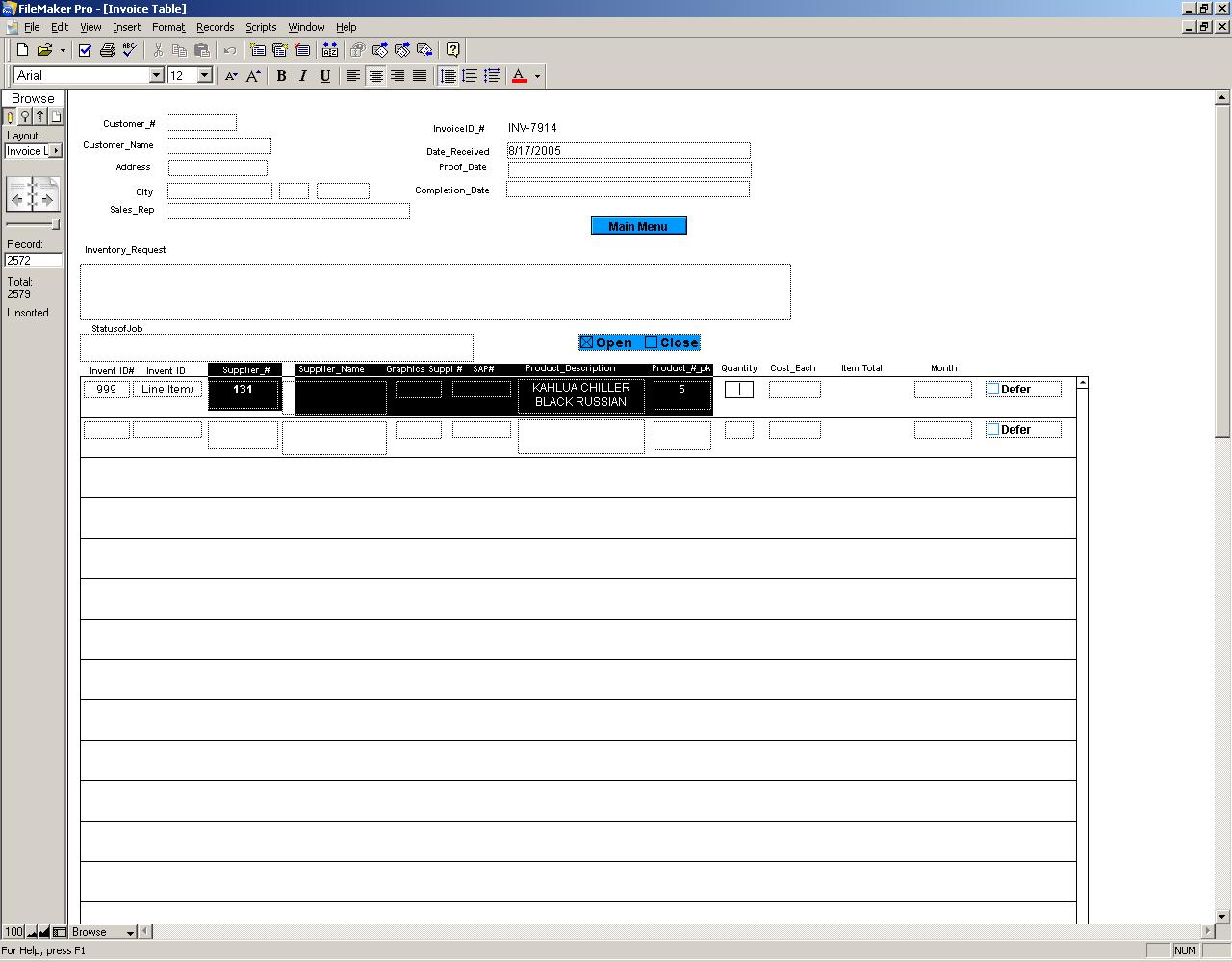

This should be fairly simple(Famous last words) to accomplish. I am trying to have a few fields auto populate, but I am having a problem with the table occurances/relationships. I want to be able to put in a product # on an invoice and have the following fields auto populate from the product#B)
Supplier#
SupplierName
GraphicsSupplier#
SAP#
ProductDescription
When I enter in the product# the ProductDescription and Supplier# are auto populating(from a lookup), but I can't get the other fields to do the same. PLEASE HELP!!I attached jpg's of my relationships and invoice table with highlighted fields.

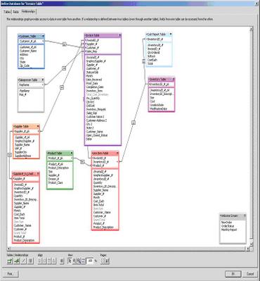

I'm afraid I can't read your relationship graph to tell your structure so it's difficult to give more specific advice. But if all the fields you want to access in your report are related, you can place those related fields directly in the report - no need to copy the data again.

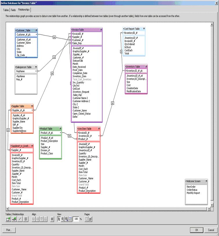

I have tried to attach a clone(w/o records) of my db, but it is still too big. If you click on the attachments in my first post they will enlarge for you. Thanks so much.
Rochelle, please collapse your table occurrences to only show the keys being used, then arrange them nicely. It is very difficult to read a graph otherwise, for us or for you. Use the little square box on the title bar of the TO. It has 3 states. Just click to experiment and see.
Basically your problem is that you have the Supplier TO attached to the Invoice itself, not to the Product TO. If each Product has its own Supplier that is where it should be; not the Invoice as a whole. Because you have possibly several different suppliers in one Invoice, per Product, which is per Line Item.
I see that you have Invoice TO to Supplier TO, then attached to Line Items, on the other side of it. But this won't work. Suppliers goes off of Products, as that is when/how/where a product has a supplier.

It is pretty easy however to attach the lines in the Relationship graph correctly. Just delete the line from Suppliers to Invoice, and reattach it to Products.
Supplier# in the main Line Items table occurrence would be a lookup, from Suppliers. The relationship* would pass "through" the Products table (automatically). This is assuming you only have 1 supplier for any particular product. Otherwise you need a join table, and a way to either get the current supplier for that product (latest entry in the join table? manually entered flag field?), or a way to choose which (for each line item, awkward).

I did make some progress, now when I put in the product # in the portal all of the fields auto-enter. The problem now is that 3 fields the Supplier Name, Graphics Supplier #, and SAP # are auto-entering the first record from the supplier table for every entry.I followed Fenton's advice on the Supplier relationship to the Product table. Any ideas would be greatly appreciated.Thanks everyone!!
If the relationship from Line Items to Products is based on Product ID, then from Products to Suppliers is based on Supplier ID, then products with the same supplier in Line Items will show the same supplier data. But products from different suppliers should show different.
Is there only 1 Graphics Supplier and 1 SAP per Supplier? That's the way you've got it set up, since they are just fields in Suppliers.
Otherwise I don't know what's going on. You need to post your Relationship Graph again (cleaned up). Or post a clone or sample of the file.
It is also possible that you are specifying the wrong table occurrence when you put Graphics Supplier and SAP in the portal. This shows in portals as the problem you mentioned, all the same as the 1st. But since they should just be related fields from the Suppliers table occurrence, I don't see how that would happen.
They should not really be looked up INTO fields in Line Items, unless they change often between suppliers and you need a historical record.
