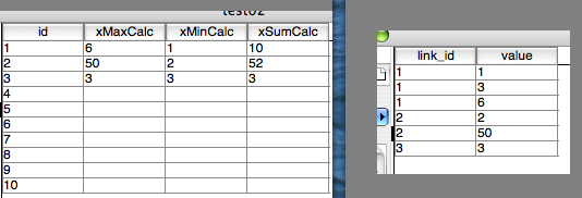

I'm also finding this problem with the MIN and SUM functions. Attatched to this message is another test file - open it in v7 and you will see 3 columns of mainly 0's. Open it in v8 and they have all been replaced by blanks.
Does anyone else have a problem with this or is it just something on my machine??? (OS X 10.4.2)

I download and try, result is same as yours.
Here are a couple of screen shots of what I'm seeing. It all seems to be working OK.
BTW, I'm on 10.4.2 also.
Hope this helps,
Michael Reade
Is that a v8 or v7 screenshot?
I get that result in v8, but in v7 all the blanks are replaced by 0's
It appears the FileMaker 8 is returning the more correct value, that if no records match the relationship, the result is null; not 0 as in 7. But, as you say, it makes certain syntax of Finds not work as (perhaps) expected. You might expect that Find <1 would return the blank records. But it doesn't. This is actually correct however, if you consider that the blank records are null, which is no value at all, so they can't be compared to a number value.
You can Find them with "=", which is the special character for finding null values. Or you can Find for >0, then Omit.
This is actually the way that it works for regular fields, and has for some time. You cannot Find for 0 in a blank number field in 7 either. So now calculations follow the same rule.
Similar logic for a function like Min(). If there is a 1 in one related record, and another is blank, the Min() is 1. But if there is a 0, then it should show 0. In 8 it correctly shows 0 as the Min(), and blanks in records with no related, or related blank values.
But in 7 it shows 0 in that record, and all the other null or blank records. Or, if you set the field number format to not show zeros, both the 0 and all the blank records are blank. Neither of these results reflects the real data. Perhaps it fits the current business logic, but it is technically incorrect, as it cannot show you which data was entered.
