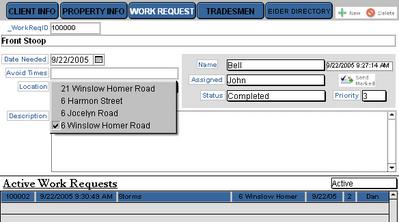

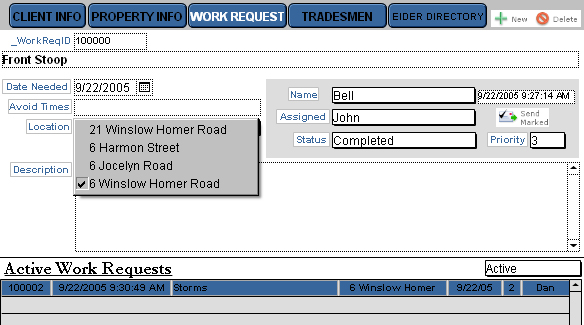

I have a layout where the clients call in and request maintenance to their properties. The office manager will get their last name (currently a pop up related back to the property layout-working perfectly) now I want the 'location' field to be dependent on what name was picked from the 'name' field.
So the name smith will only show his properties.
Is this plausible?

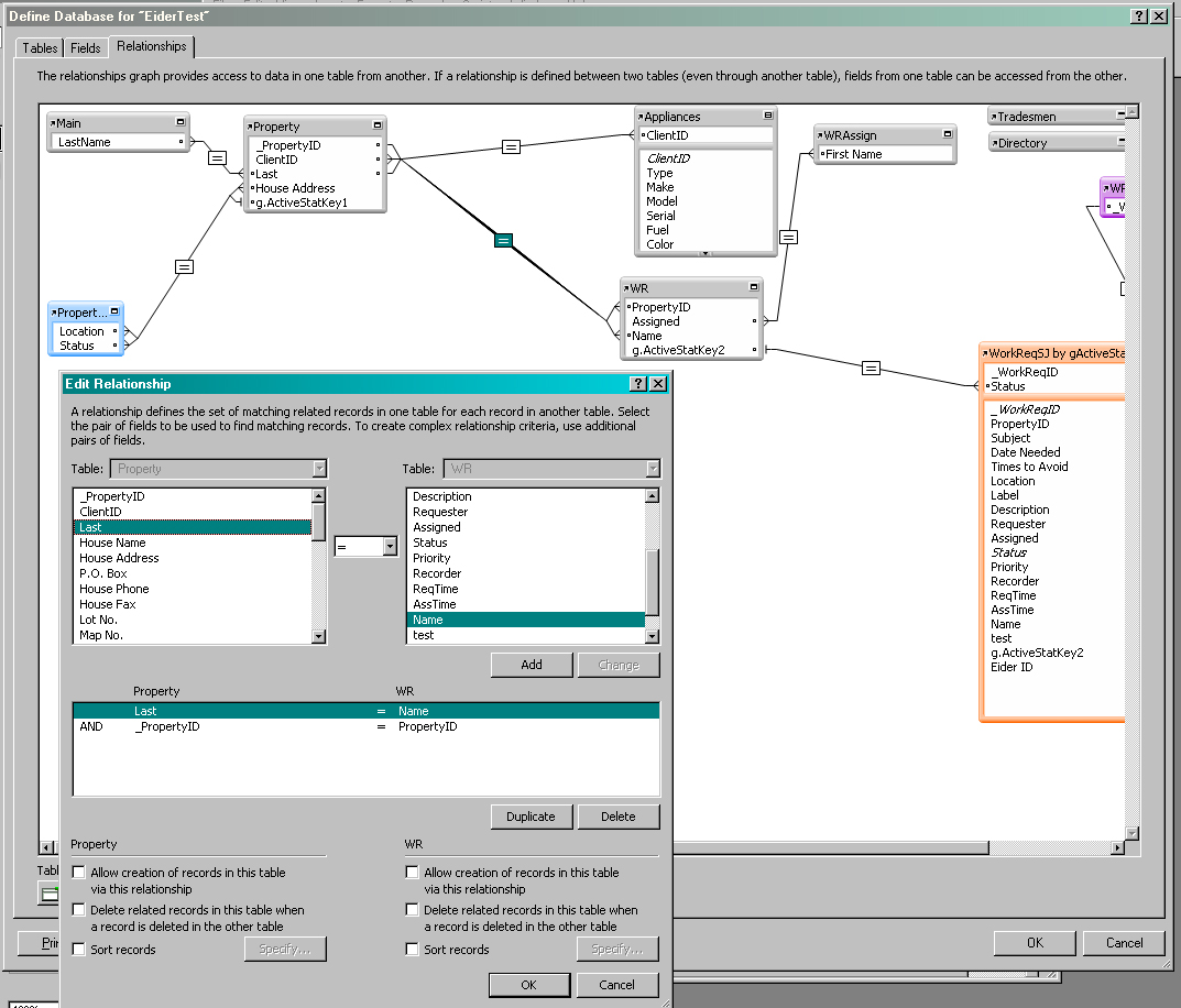

This can be approached a couple of different ways. If you have a table(ie. Locations) in which each record contains a property/location name field and a person name field, you could create a relationship between the Name field in maintenance request Table Occurrence and the person Name field in the Locations Table Occurence. Then, make the Value List for location on the maintenance layout a value list using the new relationship.

OK I figured it out, so yes it did help. But to get that to work I had to eliminate a relationship I had that referenced back to the location table which had a portal summarizing all the work requests for that property.

To avoid having to remove that relationship, create two new Table Occurrences(TO). One for the WR table and one for the Property table and make a relationship between the two from Name(WR) to Last(Property). Then use that relationship when defining the Value List. You would use values from the new Property TO and Include only related values starting from the new WR TO.
You don't need to change the TO that the existing maintenance request layout uses. Just use that new value list. I believe that will work.
