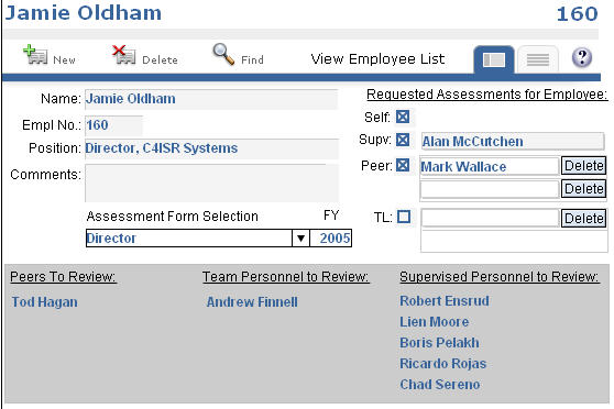

The problem is with the Team Leads(TL) and Peers (many to many). The supervisor looks at each of his personnel and decides if peer inputs and team lead inputs are called for. If so, he enters the peers and TLs for that employee. Currently, I have a Peers table set up that is another occurrence of the Employees table and I have a table called Peer Input where the field EmployeeID matches the EmployeeID in the Employees table and the PeerID matches the EmployeeID in the Peers table. That works for selecting the Peers for that employee and also creates the Peer Input form which will be used by the Peer. The PROBLEM: It is the PEER who will be coming into the database to fill out the Peer Input form and I can't figure out how to get those records to show up automatically for the Peer after the supervisor selects the Peer to do an assessment. Ideally, the Peer will come into the database and have a list of people who require his Peer assessment and when he clicks on a record in the portal, he will go to the Peer Input form that's been set up for that Employee.
I've attached a screenshot of the employee layout which may help you to see what I'm trying to do. If I got this to work correctly, then on my record under "Peers to Review" at the bottom, the name "Jamie Oldham" would show up since her supervisor has designated me as a Peer to review her, as you can see at the top right of her own record.

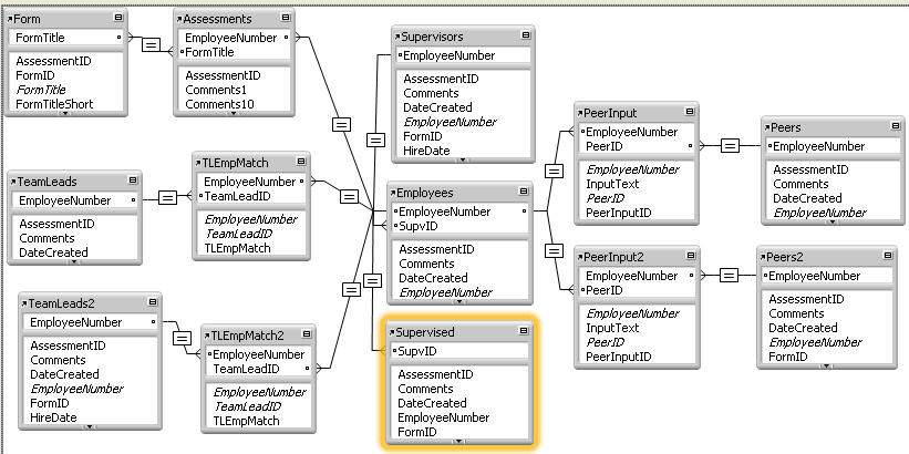

For many-to-many relationships, the usual practice is to make another table (not just a table occurence) which holds as a minimum the keys to each of the other tables. In your case the "other tables" are the same table. So this new table would associate a person to a peer. When viewing a person's record, you would have a portal with all the related peers. I've attached a quick & dirty demo of this in action. Check out the Relationship Graph & layouts to see how it works.

One thing that may be better to do before continuing: create an Entity-Relationship Diagram (ERD). This will outline exactly what pieces of info you have (entities) and how the relate to each other. Once you understand how the process you're trying to put in the database fits together, it will be a lot easier to visualize how to implement the ERD in FileMaker using tables and the Relationship Graph. Yea, it can be a PITA, but if it gets you to the point of truly understanding your process, it's more than worth the effort.

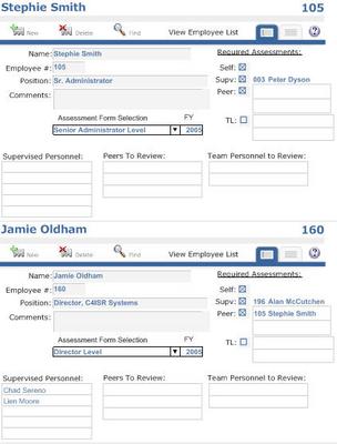

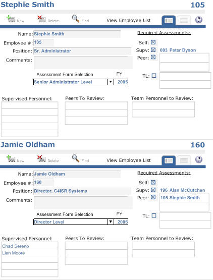

Thanks for your help, Cyborg Sam. I think I've got it figured out now (see manytomany.jpg), though I won't say it's perfect as I will probably find some problems as I go forward. Since I need to be able to see the Employee/Supervisor, Employee/Peer, and Employee/Team Lead related records from both sides on the Employee layout, I ended up adding a 2nd occurrence of the same tables for each pair. So for the Peer Input, I have the Employee table joined to the Peer table via a PeerInput form/table. For the second view of the relationship, I have a PeerInput2 form and a Peer2 table with a different relationship from the first set. All the portals have a pop-up menu using the value list of EmployeeNumbers with a second field "Name" and set only to show the name as you did in your example (thanks for that...it makes it easy to make a match record) since the PeerID, SupvID and TeamLeadID are all actually that person's EmployeeNumber. The portals at the bottom are from the 2nd set of tables (Peer2, etc) and view only as the info comes in from other records; the pop-up menu fields use the Employee:EmployeeNumber field and are formatted as mentioned above. The portals to the right, i.e., the ones that are used for inputting information for that particular employee,show records from the first relationship and are also formatted the same way as the other portals but use the field PeerID, TeamLeadID and SupvID as opposed to EmployeeNumber. Sounds confusing, doesn't it but so far everything seems to work.
