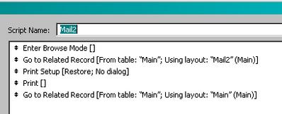

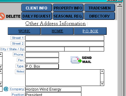

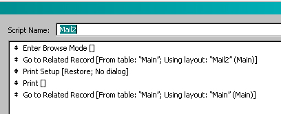

If I have one table with three different layout options pertaining to address's :: Main; Work; Home; etc.
When I run the script go to related record my option is [from table: Main] I need the option of [from layout: Work] ; [from layout: Home] etc.
How can I acomplish this?
You can attach a script parameter to each of the buttons. I like using numbers but you can uses the values: home, work, main. Then in your script you can have
If Get ( ScriptParameter ) = "home"
Go to layout [ "home" ]
Else If Get ( ScriptParameter ) = "work"
Go to layout [ "work" ]
Else
Go to layout [ "Main ]
EndIf
