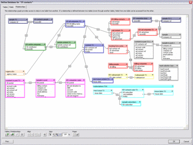

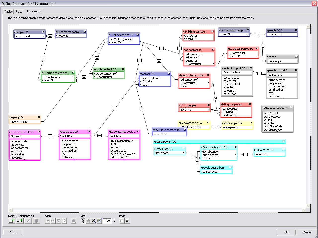

I've included a screen grab of the relationships graph, in case anyone is able to see any glaring errors in it. There are also problems happening with deleted records reappearing... but I'll start a new thread for that.
