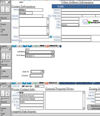

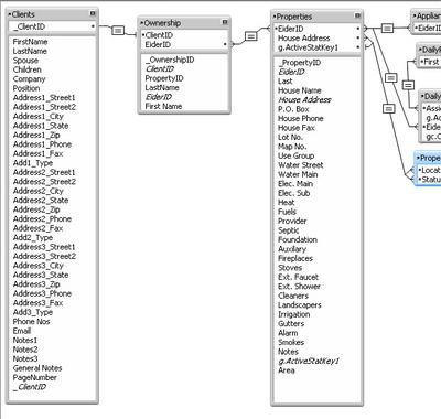

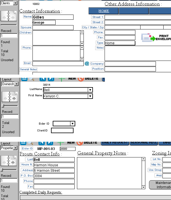

Eitherway, I'm having some major trouble with my database surrounding multiple last names from completely different families. Comment suggested I incorporate a new table called ownerships where I link the last names to the properties and that is what I am trying to do. But the problem I am having is incorporating autoentered serials. If I have a _ClientID (auto enter) and a _PropertyID (auto enter) and I'm linking them together in the ownership table no one will remember that Smith = 1178 and his property 6 harmon = 3110. asking someone to link these two things is impossible.
So I am asking you guys if anyone has any suggestions how I can make this easier, or if this is it.
What I am hoping for is a process of elimination type thing, you first select the last name, then you get a related value list for the first name, then you get another related value list for the property ID.
Maybe I am just going about this whole thing the wrong way, I am getting a little burned out by all of it.
Again, thank you for all your help.

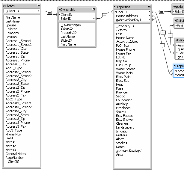

Remember, these relationships directly between Property and Client are only used for filtering the selection down (or showing the selection.) Your original join table is still required, and its ID field can even be the target of the value list or portal selection process. (Hey, you said the link between Ownership and Property was by "PropertyID", but your TOG shows a link by "ElderID", what gives?)

Ok I have seen what you have done and it will work for me, the only issue is my clients not only own multiple properties, but each property will have multiple owners. I'm afraid I did not explain my problem very well.
As you can see from the database I attached (prior) I tried linking last names from the property table into a portal within the clients table. Which worked perfectly when I only had one client to multiple properties. Once I had more than one client owning a property in addition to clients with the same last name I ran into problems.
Enter the ownership table, I created this so I could have a property table and a client table and link them so I could have my property portal within my client table.
The more I think about it, I believe my problem is that within my ownership table I have no way of narrowing your choices. If You choose Smith; John you will have 175 properties to choose from and if you choose Adams; Karl you will still have 175 properties to choose from.
So the area I can not seem to grasp is how to get what I had (portal in my clients table displaying all the properties associated with them) but by using an autoentered serial to form the relationship - since each name, no matter will have a unique ID - but to search with the last names.
Because of what you just showed me I think I can accomplish this, I am foggy on how to then tell filemaker to link (John Smith ID-1009) with (1 Cricket Lane Eider ID - MP-001-03)
-Within my ownership table I will have the layout you just gave me. This will enable me to link Smith with 7 Cricket as well as Adam with 7 Cricket without having to have multiple property records of the same thing.

Ok I've thought about it:
Within the client table I have a property assign button. It brings up a screen similar to yours but instead you just fill in the address. Upon commit the script gets the clientID and the Property ID and creates a new record in a 'hidden' ownership table which joins the two. However how does my property portal in the clinet table work? How do I create a portal to the property table through the ownership table? and/or is their an easier way to accomplish this?
You might use a selection interface like I provided, only instead of setting the ClientID in Property, set the ClientID and PropertyID in a new ownership record.
Then on the Property layout, show the portal of Ownership records, with the Client names.
