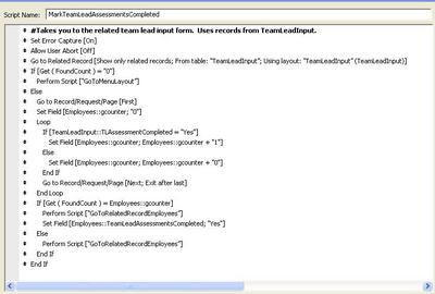

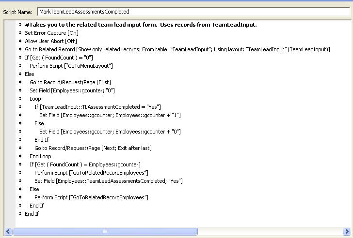

I probably could make this script simpler, but it took me long enough just to figure it out this way and I don't have the luxury of time to keep trying other things. Anyway, in case anyone is interested, attached is a picture of the script steps. I ended up using a global counter that I set to 0 and which gets a +1 for each TeamLead assessment that has been completed for an employee. If the gcounter equals the total number in the found set, then the TeamLeadAssessmentsCompleted field gets a "Yes." Rather than have this script run when a TL assessment is submitted, I will have the supervisor run it when he comes into the database. BUT since this is a script that checks the related records for just one employee, I have to insert it into a script for the supervisor so that all the employees that he is supervising will be checked, i.e., a "go to portal row" script. THAT will probably take me another 3 days to figure out:-(
