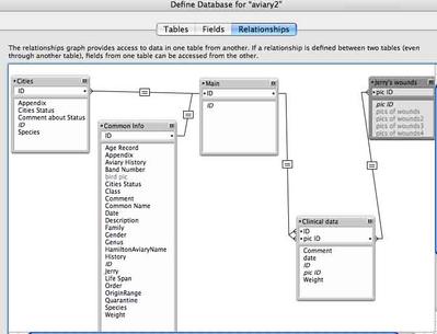

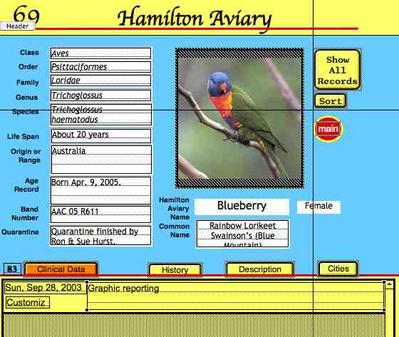

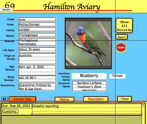

Thank you for the explanation. No, it wasn't too long. But I think I made a mistake. I deleted some fields and now I can no longer enter data into the portal fields I have for the layout clinical data. I've enclosed some jpegs to try to clarify my problem. I have that you can read them.
Bubette
Hi Bubette,
you need to compress the files before posting them to the board using the "manage files" link below the message composition box.
If you have deleted a field that was used for the relationship, that would be a problem, but then you also would not be able to view the records in the portal. Post the JPEG's again, or if you can, your files, and I'll be glad to look at them.

Alright, I now see the JPEG's. Why did you place all the fields in a separate Common Info table, in stead of in the Main table ?
I assume that Pic ID in Clinical data is an auto-enter serial as well ? If so, the relationship you have created where the ID in Main should match both ID AND Pic ID in Clinical data is not likely to work. I don't know to what field Pic ID should have previously matched ? Is it possible that you have added Pic ID to the relationship by accident ? Filemaker should have warned you if you were about to delete a field that was being used by a relationship (i.e. the field that was previously used as the match field for Pic ID). I would suggest removing Pic ID from the relationship (delete the line in the Relationship window that says "AND ID=Pic ID"), this will probably fix the problem that you cannot enter new records anymore.

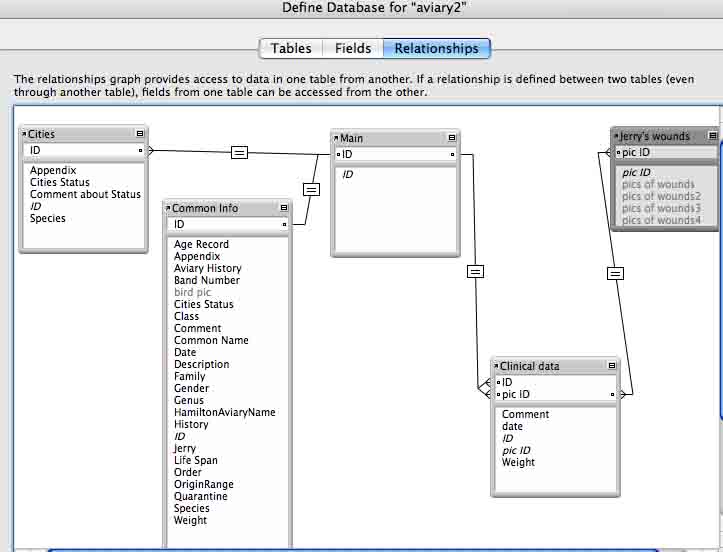

A couple things:
The "ID" field in the Clinical data table should not be an auto-enter serial number, since this is a foreign key. Also, if you wish to create Comments through the Clinical Data portal, you'll need to hit the checkbox on the relationship to allow creation of records through the relationship.

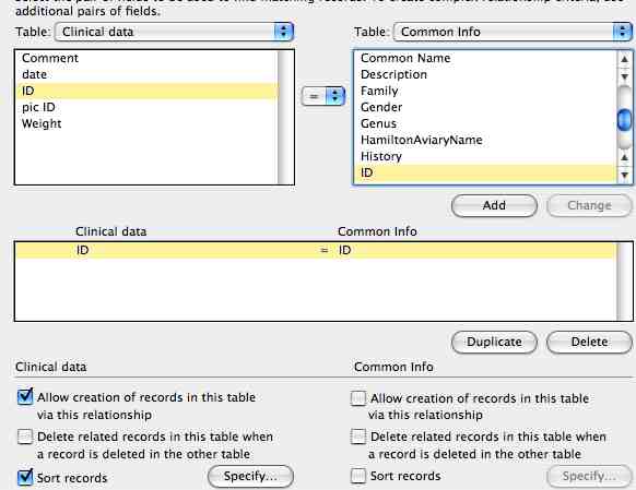

I just thought of something: I'm having difficulty entering new information into the 3 fields (comment, date and weight) that are part of the clinical table. I need to edit the relationship to allow the creation of records, (in this table via this relationship) but I'm not sure how to do that. Is there anyone that could help me?
I need to edit the relationship to allow the creation of records...
On the relationship graph, double click the relationship joining the two tables. In the "Edit Relationship" dialog, there's a checkbox to Allow creation of records through the relationship.

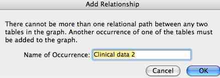

Hi Ender, Thanks again for replying. I did try that. I've enclosed a jpeg of the choices that I made. Then I received an "error" message. I've also enclosed a jpeg of that. Should I have that extra duplicate table?
I don't know why you were prompted to add another table occurence. It should not be necessary; the exiting structure already has a direct link between 'Clinical data' and 'Common Info' (this is the relationship that should be edited.)
