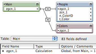

For the field to show properly, the tables need to be related to the table containing the title. Once common method is to make a "Main" table which directly relates to all other tables. Main has system-wide & user specific globals, and usually only one record. Make sure the relationships to Main always work, one way to do this is by relating global calculations where the calculation is simply the number 1 (so it's always true and always relates).

Here's a picture of the Main table concept. Notice the global calculation in each table zgcn_1 and how the tables are related using the Cross Product X instead of =. The zgcn_1 is enough with the =, I add the X just so when the Relationship Graph gets busy it's easier to see these. Note that the relationships between the other tables aren't pictured, the main idea is to make sure all major tables have a direct link to Main.
Using this relationship scheme, any layout can display any field from Main and it will appear properly. The general idea is that Main contains global fields specific to a user. In your case, a global would have the client's name.
