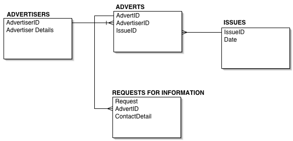

My humble experience - as someone who has filled out a RSC once or twice - would lead me to suggest the attached structure.

Wouldn't the Request for Info table need to have a field for Issue also in order for the filtered portal to work the way flyzone wants it to? And then wouldn't it make sense to have a separate Readers table since a Reader can fill out many Request for Info Cards over the course of time (various Issues)?
The Request already "knows" which Issue it belongs to, via AdvertID.
I don't quite see the need for a filtered portal. I think a report of Requests, grouped by Advertiser/Issue, needs to be sent to each Advertiser to act upon.
The readers are general public. You get a request for information from Joe Shmoe. What use is tracking him? Next time he fills the card, he's going to misspell his name and use up another record in your db. From my experience, if you fill out the card twice in a row, you get the same brochure from the manufacturer twice. They just assume the first one got lost in the mail.
Perhaps at some point it might make sense to keep a db of readers, to track interest trends ("80% of readers interested in product A, also expressed interest in product B") and such. But I think right now we are struggling with the basics here.
If I'm following your line of thought correctly, the AdvertID is not necessarily the same ID for any given company from issue to issue.
That is correct - it can be simply a serialID in the Adverts table. This way, you can associate responses with specific ads and issues. A company can have several adverts in a single issue - say a general PR ad, and two specific products. Or the same ad can run several issues in a row. But the structure allows you to generate statistics from any point of view you choose.
I hadn't looked at it that way before but it makes a lot of sense.
