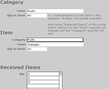

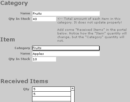

Here's some screenshots to show my results. Notice in pic 1, there's 10 (5+5) Apples. Pic 2 has 10 (3+2+5) Oranges. Yet in each pic you can see that the 'Fruit' total is 40, which is clearly wrong. Add/modify/delete as many portal rows as you like & the 'Fruit' total remains 40.
The only way to force an update is to open & save the field definition.
