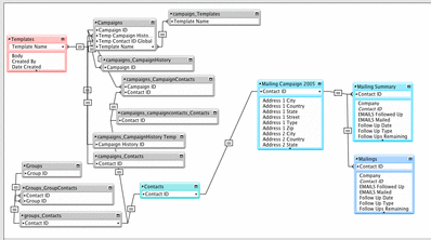

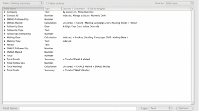

Data (linked to the primary mailing database via two portals (which I've entitled "Mailings" and "Follow Ups," respectively) is not showing up in the portal(s). The portals are set up to show related records from the primary mailing database with fields as follows:
MAILING DATE
LOOKUP field (drawing data from the primary mailing database source)
MAILING TYPE
CALCULATION fields (Counting records matching criteria of mailing types "Emails" or "Snails" (whichever the case may be).
NOTE: Also want to include additional criteria within the calculated results, which meets this scenario: count the NUMBER OF MAILINGS of a particular TYPE, on any given MAILING DATE, for any given CUSTOMER)

I've attached snapshots of two files in GIF format (which appeared to be my only option. Snapshots include the RELATIONSHIPS GRAPH and FIELD DEFINITIONS for the Mailing Summary (where the portals are set up). You may also want to view the layout for one or both forms.
I've got a hunch that the problem may (possibly) be in the way I've set the forms up. Possibly because I used an existing template (an expense form) to create the Mailing Summary. I'm not exactly sure.
Let me know if it would be helpful for you to see a snapshot of the forms themselves, field definitions for other files
or any other components.

Unfortunately the gifs that you posted will not open up if I click on them so I cannot make out the detail so lets look at the basics to see if we can bottom this out.
