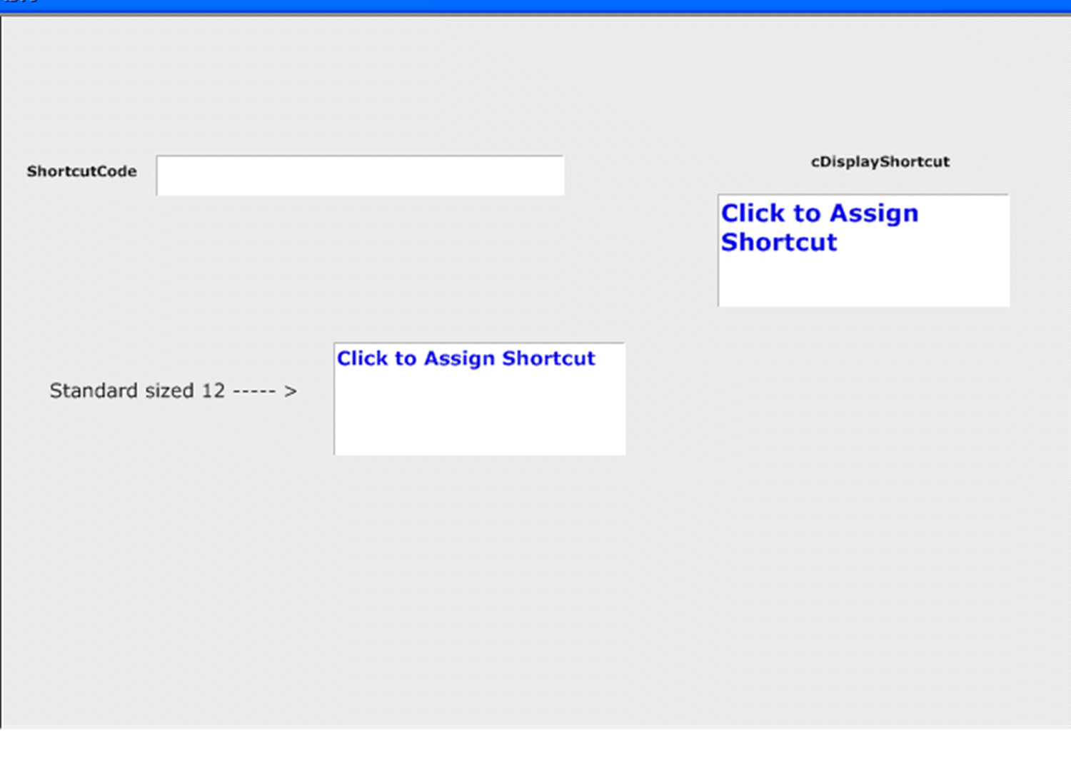

Well I use this type of text calc all the time (please see attachment)! But this time it won't work!!
If ( IsEmpty ( ShortcutCode ) ; TextSize ( Blue ( "Click to Assign Shortcut" ) ; 12 ) ; ShortcutCode )
Blue() is a simple CF of: TextColor(text; (220))
I have NEVER had a problem with TextSize or my CF colors working together and I use them a lot! But if you delete entry in ShortcutCode, you will see the "Click to Assign Shortcut" should change to 12pt. But it remains at 15.
There must be a formatting rule (or principle) I'm missing here, but I can't see it. Can you?

Well it works if I also specify the size and color of the default result (Red 15). It's possible I've always specified every result. Maybe that's the rule ... if you specify the size, you must specify them all. But I sure would appreciate clarification here. I don't have time to test it any more - I have a project to finish. :wink2:

The text "Click..." should display in 12 pt and not 15. :wink2:
Uhmmm.. I meant, I understand the description of the problem, but I don't actually see it happen. It displays in size 12, as expected.
Oh. :blush2:

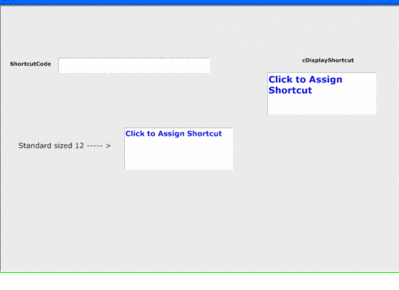

Here's what I see. I duplicated the calc and changed it's field formatting to 12 point. Do you think this was an isolated problem with 7.0v1? And yes, I'm ugrading all systems currently ... I had to wait for SecureFM and until I fixed some fixes. :wink2:

Well this is the exact file you viewed. I just copied the calc and changed the size of it.
