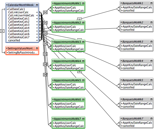

Here's the issue. I have a planner database. I want it to pull info from the schedule database, banquet database, and entertainment database and display it on all on the calendar in the planner, very much like iCal. It already shows information from the banquet database, but that's all. I am using cc calendar's free edition and molding it to my needs. Is there a way I can get it to pull dates and information from all three databases and display it on one calendar? If you haven't seen it, the way it displays events is through portals. All I really did was replace the events tables inside the cc calendar with TOs from the Banquet Database.

Using the technique you've already used, you can create three layout sets in CC Calendar, one for each of the different databases.
If you want to merge the data in one view, you can create a third layout with portals for each of the different scheduling data, side by side. This could be kind of bulky, and it is far from elegant.
Now, I've never tried this, but maybe you should implement the default event tables, and then allow record creation from relationships to each of the different tables that create scheduling data. You'll have to use a prefix on your key to indicate which table created the schedule data, which means a calculated key that adds a prefix and suffix to prevent false matches and confusion.
This is a theory, but it should work, but I bet it'll take a lot of debugging.
Here is a relationship graph and a copy of all three files involved. I just want to know if it's even possible, or if there's a perhaps trick, which is why I offered no money.
Thoughts?

I was thinking about the things you mentioned, but they are, as you said, bulky and un-elegant. I figured there probably was no way to do what I want to do nicely, but I have only been developing for a little less than a year, so I thought I'd double check. But I am considering just giving in and putting the actual planner inside the databases I would like it to display. But I thought it would be nice to be able to view them all in one place. Perhaps I can figure out an applescript and just do it all in iCal. Thanks, though!!
Calendar type displays are difficult to make even with one table. You should probably roll your schedule, banquets and entertainment into a single Events table. I am saying 'probably', because I can't see your file - it's password protected.
Okay, how about going back to using CC Calendar's original event tables. Only difference is you'll add a third key to each table. This third key will note what planner table created the event. It will also be the third part of the relationship. On the planner side, the value will be a constant for each different planner type. Say, Banquet="banquet", Wedding="wedding", etc. On the calendar side, the value will be blank and will be filled in via the relationship when the new event is created.
The next step will be to relate each of the different planner type tables tables to the common events table, linking the new constant field in the planner tables to the new field in the event table, and the other two fields as usual.
I've actually only played with this idea, and it seems to work. Each of the three source tables can interact with the fourth table.
Make sure the ability to create records in the fourth table is turned on in each of the relationships.
Good luck.

I think you have two possible routes: either create more relationships from the calendar to your different tables, or go with the union table approach (one table that consolidates everything that has a date and a time to it).
Much depends on how you want to view the data: in the first option, the various data types will be displayed separately - each comes from a different relationship, so each needs a portal. In the second option, the various data types will be bundled together (at most, sorted by type).
