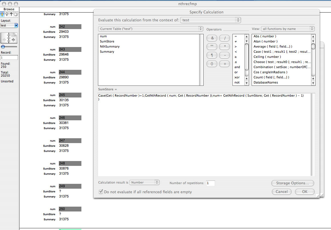

Anyone can explain why Nth record stop calculate an unstore field with the following:
Case(Get ( RecordNumber )=1;GetNthRecord ( num; Get ( RecordNumber ));num+ GetNthRecord ( SumStore; Get ( RecordNumber ) - 1)
Thank
What is the last record number that does calculate? Frankly, I am surprised that v.8 lets you do a circular definition. Properly, you should be using a custom function for this - and that is limited to 10,000 iterations.
It stop calculating at record 249, but if you click on 250 it will display the result.
