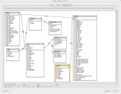

Embarrassed but true, I don't know much of TO and how to use them. I thought a simple relationship from people to jobs would do the trick.... is there any tutorial for beginners about TO's... I looked in my books and can't find any reference to Table Occurences. :)
Attached is a screen shot of my relationships.... any advice you could provide is greatly appreciated!

It sounds like that Jobs table is really a Job Assignment table--the Job a particular employee happens to be performing during a given date range. So since an Employee can have many Job_Assignments, it makes more sense to me to make the Jobs layout based on the Employee (People) table, and use a portal to show those multiple Job_Assignments. If you wish to allow a detail view for Job_Assignment use another layout, either one that leaves the tab interface, or one that shows the tabs (just be sure to have any navigation scripts incorporate Go to Related Records[] script step when changing base TOs).
That is where I started trying... but am running into problems. Attached is a screen shot... I am trying to move from 1 fake tab to another fake tab all for the same person (but the fake tabs are buttons for other layouts) For example, find Joe Blow.... go to Personal Tab and fill out his address etc (that goes in People table)... then still under Joe Blow... go to Position Info (which really is job assignment- thank you for that) and fill out his base salary and hire date etc (which goes in the job table-related to People)... and so on and so on.
