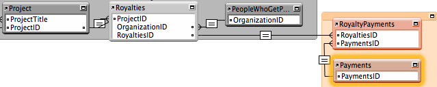

Take a look at the T.O. diagram that I've attached.
I have a portal on a "Project" layout referring to "Payments."
I'm assuming you mean to add in the calculation in the Royalties table, but that doesn't work for me. Are my relationships messed up, or does the RoyaltyPayments subtable necessitate a different approach? Thanks.

the problem is that since you are creating payment records from the projects table, and with the way you have the relationships set up, there is no way that the correct RoyaltyID can be set in the Join Table (RoyaltyPayments). Each time a new record is created in RoyaltyPayments, RoyaltyID is automatically set to the value of the first related record from Royalties to Projects. Therefore, records you create like this are not properly related to the Royalty record you think they are.
So, there should be a mechanism where you can choose the related RoyaltyID when you create the payment. The way to do is is to create a TO for payments, directly from Projects, set to allow creation of records. Then, using a value list (based on related values from Royalties) the user can select the correct Royalty.
I've modified your file, please take a look at it. Note that you do not need a join table for Royalties and Payments : this is a straightforward one-to-many scenario (one royalty can have multiple payments, but one payments only relates to one royalty).
