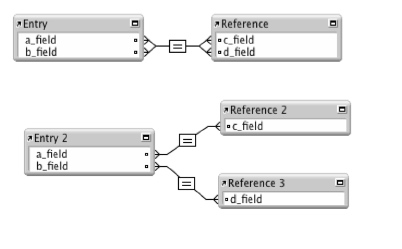

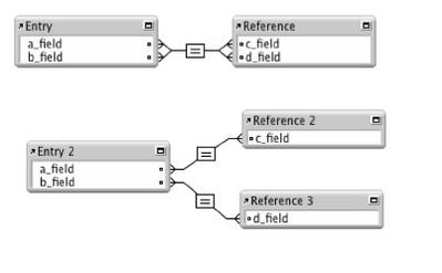

Take a look at the graph above, to make the first relation lock are both values bound to be in the same record, while the next isn't so strict. To examine if a match a relation away exists do use the IsValid( function... this means that the updating autoenter in each of your field needs to look like this - lets take the first one:
Case(IsValid ( reference::c_field ) and IsValid ( reference 2::_field );TextColor ( a_field ; RGB ( 255 ; 0 ; 0 ) );a_field)
