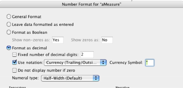

That an awful lot of storage you're using on single quote's! I would prevent storing styling data in the field at all, when it can be accomplished as shown above.
