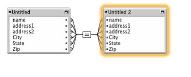

I want to filter in table A records from table B being able to use all the fields (but not at once) as filtering criteria.
It's the "but not at once" that really are bothesome - So it's not the above graph you mean, hoefully are you aware that you then via script should deal with 2^5 combinations?? But the objective was a non scripted solution wasn't it?

thank you a lot, Søren Dyhr and John Mark Osborne. Both the graphic and especially John Marks file helped me a lot in finding a solution.
the clue was to work with two calculation fields that filters the related records, pointing to a third field that contains the searched data. fantastic. :
