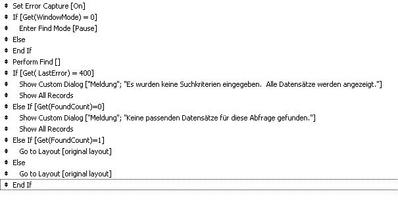

Translating was easier than I expected, just had to change the user interface language. I've added a screenshot of the search script I'm using.
Should be able to add the sort script after the last End If step.
You are right, it works like that.

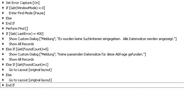

There is a "Search" button in each of my different layouts. Before, I only used it to go to "find mode". I've changed that now, specifying a simple script (see attached picture) for it - and it works just fine.
