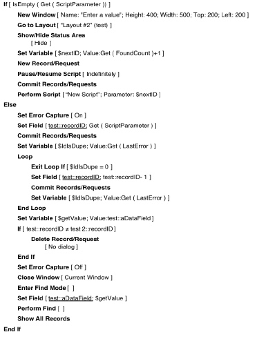

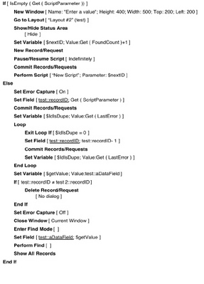

I do on the other hand consider the use of globals exaggerated, although it might have it's place here? I have the habit of being critical to the methods of crafty developers as well as newbees, and have therefore toyed with how to avoid a global in this case.
Take a look at the above scripting, it's a paused recursive script, which running thru's provides the records with ID's. There are two issues in this
1) In multiuser environment might two users create records almost simultainiously ...if an ordinary autoenter was in use would the ID's very quickly get very very large and put a strain on the indexes to send as packages over the network ...so I have chosen a "stuff the holes in the cheese"
approach.
2) If a record is deleted is there a lower record ID available, why not use it?
And why is it that I find globals needs to get stigmatised?? They're stored on the local machine, so all dealings with ohter fields will cause chatter over the network ...the good question is then if my WEIRD way of substantial scripting the matter, really makes cut's in this chatter or just makes it occure in another way?
I'm not at present in an environment where I can measure it, but I know that I would use this tool to monitor it:
http://www.entropy.ch/software/macosx/welcome.html#tcpflow
I do this because "questioning things" is the engineers/developers most urgent behaviour/qualification of them all, in order to get into a topic - although it might prove to be a cul de sac, might something be learned from it anyway!
