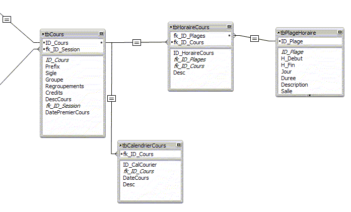

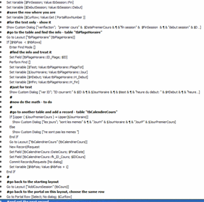

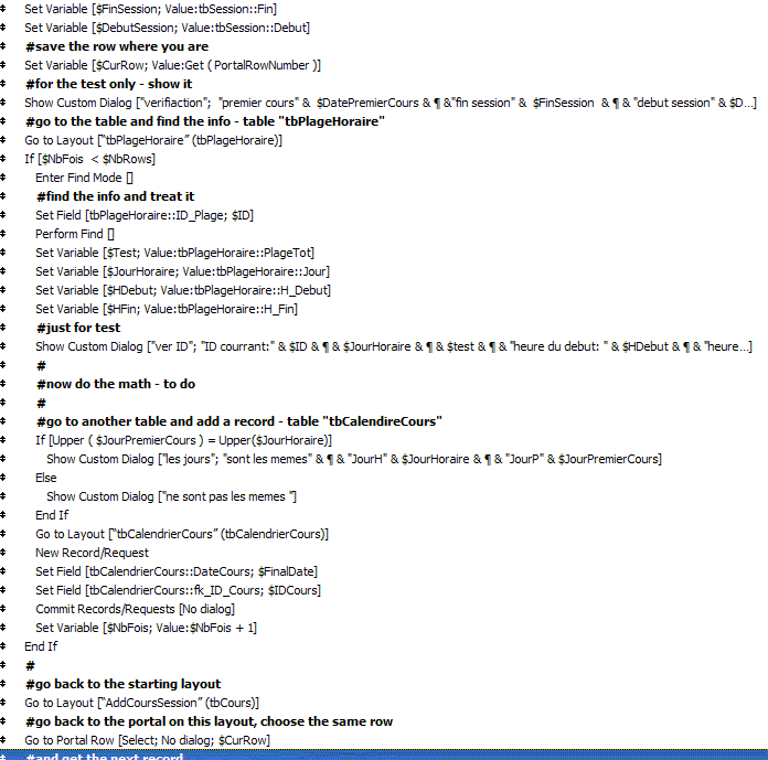

I owe you a beer … It worked the way I expected though I slightly modified the script. All tables are related but on the layout I have 2 tables the main – tbCours and in the portal - tbHoraireCours. I use a script to do some math based on the values from the layout. In the script I need to get the key from the portal (tbHoraireCours), go with this key to the tab tbPlageHoraire, find the rest of the info, do some math and with the result of all of this, go to 4th table (tbCalendrierCours) and make a new record.
Now I can continue this was just a part of the rest.
