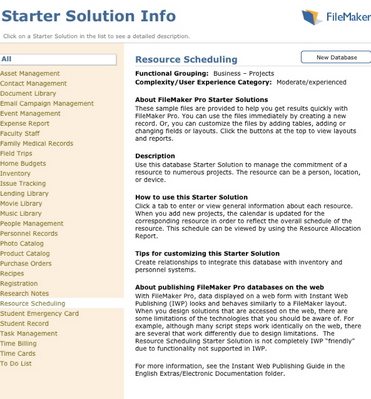

I have been looking at the filemaker template file resourse scheduling and managed to get the buttoms working through scripts. Now I only have to figure out how to make the information appear in the portal.
Looking at the template a few things don't make sense to me:
In the new project layout the fields you fill in are from "current table::) Calendar" although the layout is called "new project"
The portal in Resourse scheduling is showing the related records from Project Resourse ID? Nowhere in the define database can i find Project Resourse ID as a field nor is it as a layout. Although it is in the relationship window. What is this Project Resourse ID? And why does the portal show records from Project Resourse ID instead of Calendar where you fill in the info.
