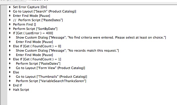

I'm running your script within my search script (attached below) but the calc only returns the FoundCount not the search criteria. I think this is a problem with my portion of the script, not yours! Do I specify a first field in 'GoToField [select/Perform]' ?

I just noticed that your script was running AFTER my change of layout. Everything is working fine now.
