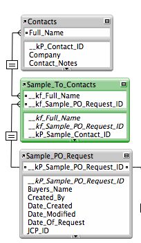

The problem I can't figure out, is that the entity that sends and receives is the same: a Contact. How can a contact be 2 different things at the same time?
Specifics: (looking at contacts.jpg)

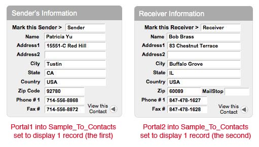

I have a Sample_Request table where I generate the request and setup the relationship through 2 portals into the green join table (Sample_To_Contacts) between the request and the contact.
I kinda have it working but I know it's not the correct way to do it. (Notice I said 2 portals...looking into the same table with the same relationship...this seems bad) *see weirdportals.jpg
On the Sample_Request table I have 1 portal set to display 1 record which the user will mark as Sender.
Right next to that I have another portal set to diplay 1 record (starting on row 2) which the user marks as Receiver.
The 'Sender' and 'Receiver' fields are in the join table.
It's kinda working now, but the design is poor.
Relying on the user to mark them correctly is too risky and I don't like it. I want 2 unique portals clearly marked as Sender and Receiver so that any contact they pull up in the Sender Portal, is really a sender...and same for the Receiver.
I'm guessing that I need 2 TO's of the join table as well as the Contacts table? I tried doing that but wasn't sure how to setup the relationships.

Hello,
I "think" you are making it more complicated then it is.
In your Sample Request Table Occurrence Group you need to set up a relationship to contacts for both receiver and sender.
I have attached a small sample, let me know if you have any questions, and I will try to help.
Good Luck!

I think I get it, now.
So what you're saying is I don't even need the join table between the Request and the Contacts.....
oh...wow...
I guess I did over-complicate it. I'm still getting used to figure out what is truly a many-to-many relationship.
I incorrectly reasoned that since the request would hold more than 1 contact (A sender + A receiver) and that 1 contact could be associated with many requests...hmmm.
I'm still rolling it around in my head but I think you're right!
Thanks!
Because a Sample only has 1 sender and 1 receiver you do not need a join table. The challenge here is more how to make a decent interface for choosing. Because you can only be on either the "sender" or the "receiver" record (or neither) at any one time.
I think the best interface would be to be on neither Contact record,* but have 2 tallish narrow filtered portals, in the Samples table, potential senders on the left, receivers on the right, with your 2 smaller cards in between. Clicking a name in the portals sets their ID into one of the two foreign keys, which the other data either just shown relationally, or looked up, depending on whether you need an absolute historical reference or not.
*Unless you naturally start on one of the Contact records. In which case you only need a portal for the other, after creating a new record for them (as sender?) in Samples.
