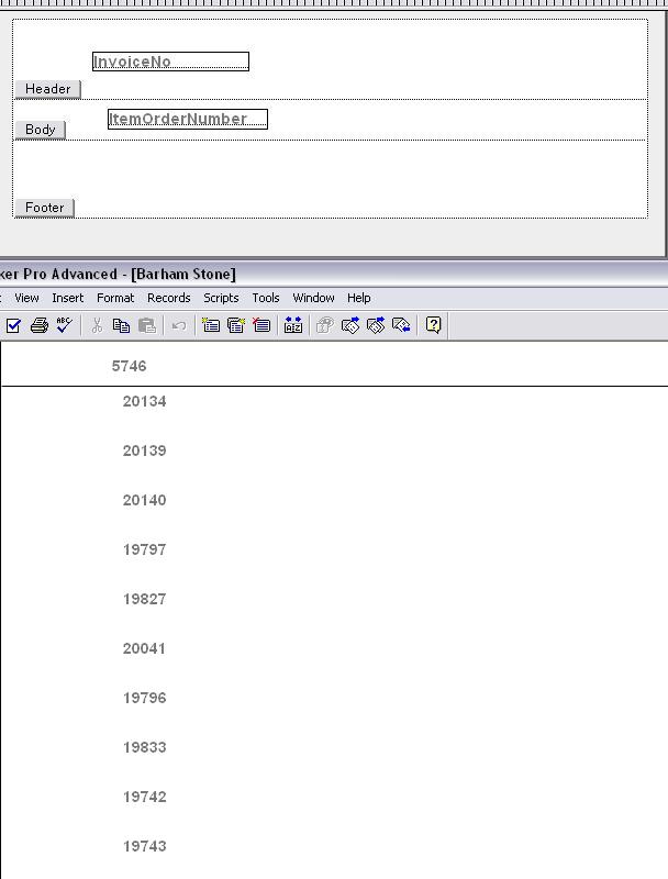

I still can't get it to work, here is a screenshot of what i am currently trying to do
thx
finally sussed it! Sometimes I could only get it to work with the wizard and grouping option within that. Only seems to work in print view and when i print it it has to be set as 'records being browsed'. It is fine though as I will have the 'rougher' layouts for viewing and these proper ones for printing. is this a common practice?
